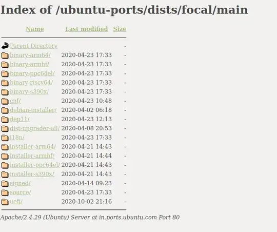

E: Failed to fetch http://in.ports.ubuntu.com/ubuntu-ports/dists/focal/main/binary-i386/Packages  404  Not Found [IP: 91.189.88.152 80]
E: Failed to fetch http://in.ports.ubuntu.com/ubuntu-ports/dists/focal-updates/main/binary-i386/Packages  404  Not Found [IP: 91.189.88.152 80]
E: Failed to fetch http://in.ports.ubuntu.com/ubuntu-ports/dists/focal-backports/main/binary-i386/Packages  404  Not Found [IP: 91.189.88.152 80]
E: Failed to fetch http://in.ports.ubuntu.com/ubuntu-ports/dists/focal-security/main/binary-i386/Packages  404  Not Found [IP: 91.189.88.152 80]
E: Some index files failed to download. They have been ignored, or old ones used instead.

There is no binary-i386 subdirectory on that server which is why you can't connect to it.
Suggest examining whatever procedure told you to attempt this.
