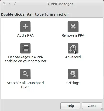

  2. Open the Y-PPA-MANAGER:
    sudo y-ppa-manager
    Y PPA MANAGER
  3. Navigate to Advanced → Scan and remove duplicate PPAs.
    Advanced options.
