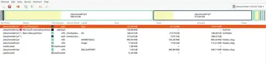

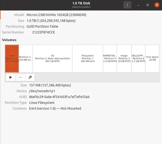

My Dell XPS 17" laptop has a 1T hd with Windows and Ubuntu Desktop 20.04.3 LTS installed. here is a picture of the current situation, key is the partition I have formatted: enter image description here enter image description here

I wonder, what have I deleted looking at the picture? the second 134MB partition says to be a Microsoft Reserved partition, so I suppose the key partition I formatted was the Ubuntu boot?
Do you think that if I install the Ubuntu boot in the key partition I will be fine to start the Win/Ubuntu partitions again?
