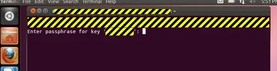

After adding the SSH key with ssh-copy-if to the remote host, I get the following prompt in terminal (GNOME Terminal 3.0.1) when I'm logging in:
ssh -i .ssh/Password-Protected-Key user@host
Enter passphrase for key '.ssh/Password-Protected-Key':

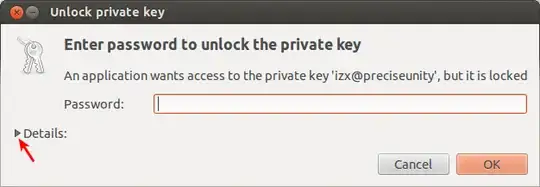

  • When you connect after adding the public key to the remote server, you'll get the GUI ssh-add dialog:

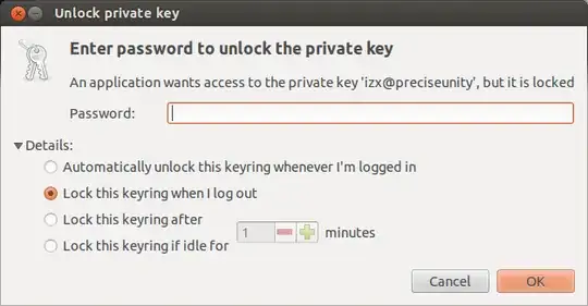

  • Expand the "Details" by clicking on the triangle, and you'll get the below. The default is "lock keyring when I log out", which requires you to enter the password once per session:

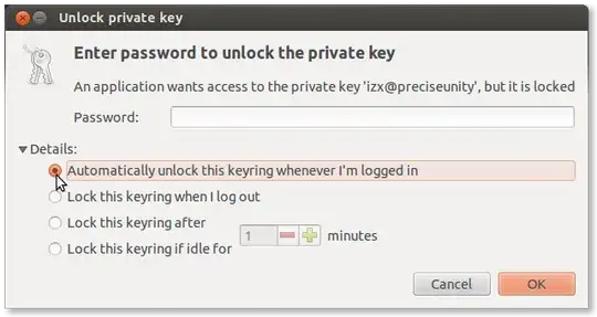

  • Change it to Automatically unlock...whenever I'm logged in, which means it will work whenever you have logged in to your session -- it's "controlled" by your user password. It will persist across reboots.
  • Enter the key passphrase once and that's it - the key is authenticated via the initial successful login to your desktop environment.
