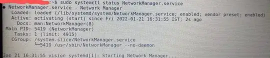

systemctl status NetworkManager.service

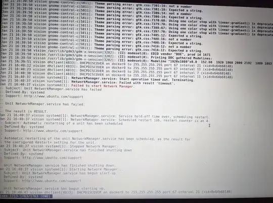

journalctl -xe
Here are the outputs for the respective commands.
Systemctl status output pic
Journalctl output pic
Please let me know what more commands I can run and see.
Sorry for the formatting and images, I'm using phone as I'm unable to access wifi on my laptop.
P.S Restarting didn't work.

First try to simply start that
sudo systemctl start NetworkManager.service
if it doesn't check the configuration files.
/etc/NetworkManager/NetworkManager.conf
Some people mentioned, unmanaged devices caused failure. Ethernet device not managed
