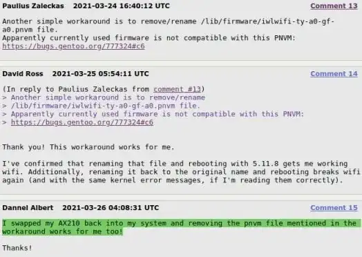

Kernel Bug 212371 - iwlwifi
Intel AX210 Wi-Fi card does not work since updating to 1.196
Renaming file iwlwifi-ty-a0-gf-a0.pnvm to iwlwifi-ty-a0-gf-a0.pnvm.old
In the terminal:
sudo mv /usr/lib/firmware/iwlwifi-ty-a0-gf-a0.pnvm  /usr/lib/firmware/iwlwifi-ty-a0-gf-a0.pnvm.old
