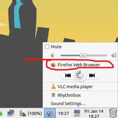

Where on Ubuntu Mate do you set the default app that displays on the "Indicator Applet Complete" when you click the speaker/sound icon?
I have checked many settings and options. They are all set to Rhythmbox.
But Firefox is set and I have yet to figure out how to change that.

Yes, Rhythmbox is set as the Preferred Application for "Multimedia Player".
Yep. The last player gets the focus+controls on the sound indicator.
But it was not working for Rhythmbox.
If I run VLC, it gets the focus+controls. If I then open an MP3 in Firefox, it returns to Firefox (last one used).
I removed/purged and reinstalled Rhythmbox. Now it works again. It now gets the focus+controls on the sound indicator.

I also found the d-conf settings... (these two do not exist on my system: org.freedesktop.MediaPlayer or org.mpris.MediaPlayer2)
.org.canonical.indicator.sound.interested-media-players (these show on the sound indicator).
['firefox.desktop', 'vlc.desktop', 'rhythmbox.desktop']
com.canonical.indicator.sound.preferred-media-players
[rhythmbox.desktop']
Again, thanks for the assist.
The fix was to remove+purge and reinstalled Rhythmbox.
