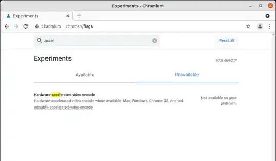

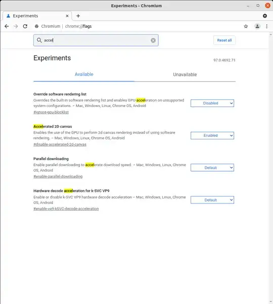

If I use the "blurred background" feature in a video call in Chromium, then the CPU fan gets very loud.
I have quite new Lenovo Laptop.
Maybe Chromium can't use the hardware acceleration.
Output of chrome://gpu

Rasterization: Software only. Hardware acceleration disabled
Raw Draw: Disabled
Skia Renderer: Enabled
Video Decode: Software only. Hardware acceleration disabled
Video Encode: Software only. Hardware acceleration disabled

Accelerated video encode has been disabled, either via blocklist, about:flags or the command line.
Disabled Features: video_encode
Accelerated video decode has been disabled, either via blocklist, about:flags or the command line.
Disabled Features: video_decode

Hardware acceleration seems rather hit and miss with the Snap version of Chromium. If you are not using an Nvidia graphics adapter in your recent notebook, then the answer to your question about using hardware accelerated video encoding is a definite "maybe".
If you haven't already, take a look at the settings available in chrome://flags:
Chromium - Available
For my less-than-recent Lenovo X1 Carbon, there are a couple of options available. However, hardware accelerated video encoding is not one of them:
Chromium - Unavailable
If you are not wedded to the Snap version of Chromium and are open to using a Flathub installation, then you can choose between the Chromium Browser and the "Ungoogled" Chromium Browser packages. These have support support for VA-API, OpenH264 and libfdk-aac, which are required for hardware acceleration on many systems.
Alternatively, there is the Mint package, which can be installed via apt in up to seven steps on your Ubuntu system.
