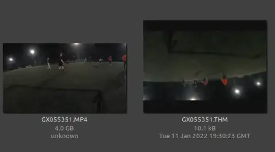

I am rather confused why nemo is reporting that some files have no date set. Which means I cannot order my files by Date. This is only happening with my GoPro videos I will add. But when checking I can see that the Media Create Date is indeed the correct time of recording.
How I get it so the correct date is shown in nemo and in bash when sorting files for my scripts:
Date Unkown

Stat of the broken file:
14_Training$ stat ./GX055351.MP4
  File: ./GX055351.MP4
  Size: 4004635826  Blocks: 7821560    IO Block: 4096   regular file
Device: 821h/2081d  Inode: 19475       Links: 1
Access: (0777/-rwxrwxrwx)  Uid: (    0/    root)   Gid: (    0/    root)
Access: 2022-01-12 23:32:35.441047700 +0000
Modify: 1970-01-01 01:00:00.000000000 +0100
Change: 2022-01-12 23:32:33.504918500 +0000
 Birth: -
