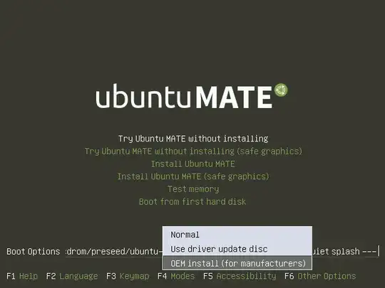

  1. Boot the system into OEM install
    • In Ubuntu MATE 20.04 LTS (and earlier) press F4 in the bootloader menu, select OEM Install (for manufacturers) and press Enter
      OEM install selection from isolinux bootloader
      Press Enter on Try Ubuntu MATE without installing, wait live system to boot.

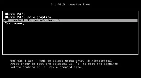

    • Select OEM Install (for manufacturers) in newer versions like upcoming 22.04 LTS directly
      OEM install selection from GRUB bootloader

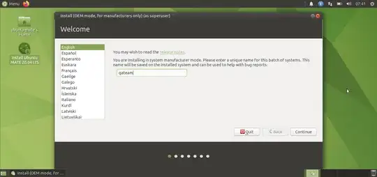

  3. Optionally provide series name, for example QATeam
    provide series name
