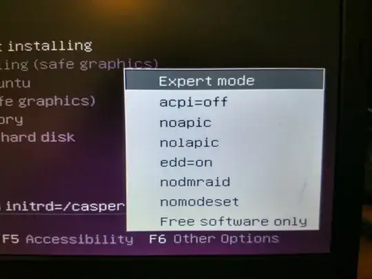

UPDATE: I formatted the USB drive and rebuilt the bootable USB, downloaded the ISO again. Same results. But, I did try the "F" keys at the bottom of the screen
F4 Gives me this:
F4 Gives me this
F5 Gives me this
F5
F6 Gives me this
F6
I did notice that after hitting F6 there is a line just above the F keys that says Boot Options and then "file=/cdrom/preseed/ubuntu.seed only-ubiquity initrd=casper/initrd quiet splash ---". I do not have anything in the cdrom drive. Why would the creation of the USB use the cdrom to install the OS?
