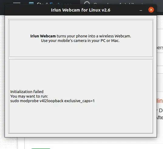

Besides this other problem I had with irium webcam on linux, when we close irium webcam and try to open it again we get the message:
Running this command doesn't make the app work. The only way to get iriun to work again is to reboot the computer.
When I run it directly from terminal iriunwebcam, the terminal doesn't show me any error message or any message at all, just opens the application GUI.
Does anyone knows how I could fix that?
Edit
I'm using Ubuntu 21.10 and I remember having the same problem using the Pop OS 20.xx (don't remember the other numbers).
Looks like each time we face this error with iriunwebcam,
we have do a "cleanup" of v4l2loopback device running:
sudo rmmod v4l2loopback;
sudo modprobe v4l2loopback exclusive_caps=1
This works ubuntu 22+ version too.
