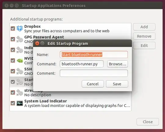

  5. Fire up the Startup Applications from the ubuntu menu. Add your scripts to the startup.
    Add startup applications
  6. Now, there is only one problem left, at the time when you login, the scripts might not catch the very first bluetooth event. This is because your bluetooth device might be connected before your script is initialized in the background.
