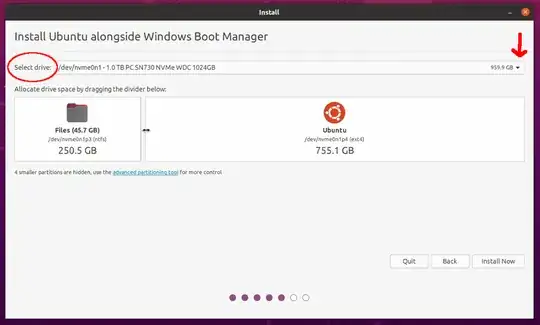

You can decide on which drive you want to install Ubuntu during the installation. In the "Install Ubuntu alongside Windows Boot Manager" dialog, you see the "Select drive:" pulldown. It allows you to select the drive.
