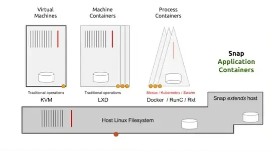

I think this slide from Mark’s presentation on Container Camp 2016 explains a lot in a single image, and makes a lot of sense to me:
Video link: Why we need a different container purely for apps - Mark Shuttleworth (Canonical) - YouTube
To sum it up in short:
  • LXC/LXD are “machine containers” with a persistent filesystem that works like a VM
  • Docker are “process containers” with an overlay filesystem over a static image (with options for persistent storage)
  • Snaps are “application containers” that directly extends functionality of the underlying host
