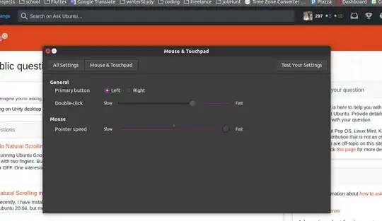

I just installed Unity coming from Gnome and I don't see natural scrolling option there. What do I need to install on Ubuntu 20.04 LTS?

Okay, I found the solution that works on 18.04 which also has the same problem. Dconf and gnome settings have no effect.
