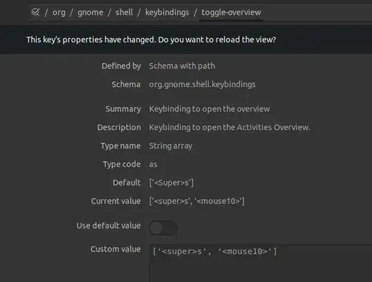

I'm using Ubuntu 21.10 with wayland. xdotool does not work with this setup.
I've trying to use dconf to bind a function to a mouse button (toggle-overview). I can not find anywhere a list of the valid sequences for keys in dconf.
I'm willing to use an xdotool equivalent, but I've yet to see a supported one for Wayland.
I've used xev to tell me it's button 10 that I want to bind, I just don't know how to tell dconf how to accept button 10.
I tried binding other key sequences (^C for one) just to see if those would work. Those sequences do just fine.
How does one specify a mouse button in dconf?
shown below in a image of the dconf-editor where I'm trying to enter the mouse button, the "mouse10" text. That value doesn't work. If I replace that with 'c' it will then work.
I'm trying to find the correct value to use for "mouse10"

I don't know why you want to force the mouse button binding via dconf. I don't even know if that is possible. The dconf menu you quote is for binding keys to actions, not mouse buttons to either keys or actions.
The "canonical" method for what you want to achieve (although not via dconf) is very simple, via xdotool.
