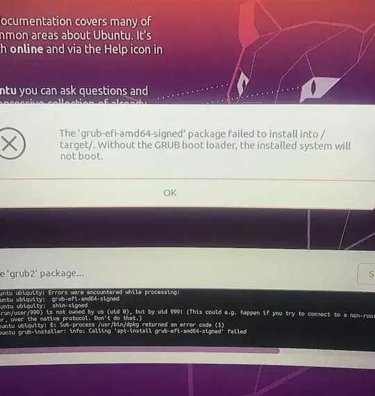

Idecided to install Ubuntu on my Mac Mini, and delete the macOS partition. While installing Ubuntu 20.04 on my Mac Mini 2018 model A1993 I came across some errors and the installer wasn't able to finish. The first fatal error was grub-install '/dev/nvme0n1' failed. Then I ran Boot-Repair and it showed that Locked NVRAm is detected. Also the paste URL was indicating that Both primary and backup GPT are corrupted. Try making a fresh table and using Parted's rescue to recover partitions. Can anyone guide me in the right direction? This is my first time doing this type of install.
Error 1:
Error 1
Error 2:
Error 2

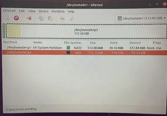

GParted partitions:
GParted partitions

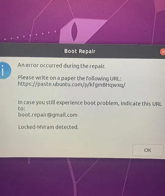

Boot-Repair error:
Boot-Repair error
https://paste.ubuntu.com/p/vm6gZhNyJJ/
============================ Boot Repair Summary ==============================
Error: Both the primary and backup GPT tables are corrupt. Try making a fresh table, and using Parted's rescue feature to recover partitions. cat: /sys/firmware/efi/vars/SecureBoot-8be4df61-93ca-11d2-aa0d-00e098032b8c/data: Input/output error
Recommended repair: ____________________________________________________________
The default repair of the Boot-Repair utility will purge (in order to fix packages) and reinstall the grub-efi-amd64-signed of nvme0n1p2, using the following options: nvme0n1p1/boot/efi, Additional repair will be performed: unhide-bootmenu-10s use-standard-efi-file
/boot/efi added in nvme0n1p2/fstab Mount nvme0n1p1 on /mnt/boot-sav/nvme0n1p2/boot/efi No nvme0n1p2/boot/efi/efi/ ubuntu/mint folder chroot /mnt/boot-sav/nvme0n1p2 apt-get -y update Purge the GRUB of nvme0n1p2 grub-efi-amd64-signed available The following additional packages will be installed: efibootmgr grub-efi-amd64-bin The following NEW packages will be installed: efibootmgr grub-efi-amd64-bin grub-efi-amd64-signed 0 upgraded, 3 newly installed, 0 to remove and 190 not upgraded. DEBCHECK debOK, grub-efi-amd64-signed DEBCHECK debOK shim-signed available Please type: sudo chroot "/mnt/boot-sav/nvme0n1p2" dpkg --configure -ansudo chroot "/mnt/boot-sav/nvme0n1p2" apt-get install -fynsudo chroot "/mnt/boot-sav/nvme0n1p2" apt-get purge --allow-remove-essential -y grub*-common shim-signed shim-signed available linux-headers-generic available linux-signed-generic NOT available (apt-cache policy problem) Then type: sudo chroot "/mnt/boot-sav/nvme0n1p2" apt-get install -y grub-efi-amd64-signed shim-signed linux-headers-generic
Unhide GRUB boot menu in nvme0n1p2/etc/default/grub
== Reinstall the grub-efi-amd64-signed shim-signed linux-headers-generic of nvme0n1p2 ==
grub-install --version grub-install (GRUB) 2.04-1ubuntu26.13
efibootmgr -v from chroot before grub install show_order(): Input/output error Skipping unreadable variable "Boot0080": Input/output error Skipping unreadable variable "BootFFFF": Input/output error
uname -r 5.11.0-27-generic
grub-install --efi-directory=/boot/efi --target=x86_64-efi --uefi-secure-boot Installing for x86_64-efi platform. grub-install: warning: Cannot read EFI Boot* variables. grub-install: warning: read_file: could not read from file: Input/output error. grub-install: warning: vars_get_variable: read_file(/sys/firmware/efi/vars/Boot0080-8be4df61-93ca-11d2-aa0d-00e098032b8c/raw_var) failed: Input/output error. grub-install: warning: efi_get_variable: ops->get_variable failed: Input/output error. grub-install: error: failed to register the EFI boot entry: Input/output error. Exit code: 1
dosfsck -a /dev/nvme0n1p1 fsck.fat 4.1 (2017-01-24) 0x41: Dirty bit is set. Fs was not properly unmounted and some data may be corrupt. Automatically removing dirty bit. Free cluster summary wrong (123043 vs. really 121706) Auto-correcting. Performing changes. /dev/nvme0n1p1: 25 files, 9078/130784 clusters
rm -Rf /dev/nvme0n1p1/ubuntu .. fedora
efibootmgr -v from chroot after grub install show_order(): Input/output error Skipping unreadable variable "Boot0080": Input/output error Skipping unreadable variable "BootFFFF": Input/output error Error: NVram is locked (Ubuntu not found in efibootmgr).
chroot /mnt/boot-sav/nvme0n1p2 update-grub Sourcing file /etc/default/grub' Sourcing file/etc/default/grub.d/init-select.cfg' Generating grub configuration file ... Found linux image: /boot/vmlinuz-5.11.0-27-generic Found initrd image: /boot/initrd.img-5.11.0-27-generic grub-probe: error: cannot find a GRUB drive for /dev/sda1. Check your device.map.
Unhide GRUB boot menu in nvme0n1p2/boot/grub/grub.cfg
An error occurred during the repair.
Locked-NVram detected.
