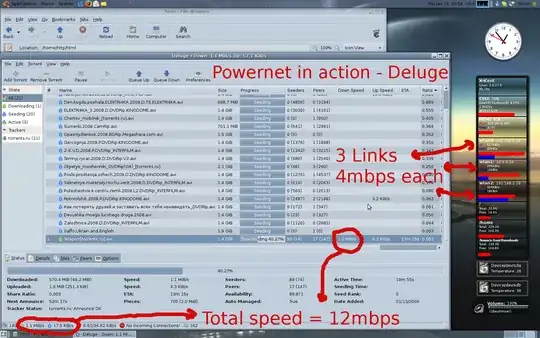

You can configure Linux routing to use more than one gateway easily. The more problematic part is that if one of the gateways is down, you want your machine to stop using it and start again once it's up. I have once written a script that does it (only for wireless connections). You can see torrent working and utilizing 3 different wifi internet connections here:
If you want to get the script to understand what commands I used or try running it see: https://sourceforge.net/projects/powernet/
The first versions have just the configuration commands, the later versions stop using a connection if the gateway of that connection cannot be reached and retry after some time.
Expect newbie coding quality., I was just studying bash at that time.
Edit(link change and more explanation): As I see people get confused over "binding" connections and "load balancing" connections. When you are connected to more than one network and each has it's own "gateway" your system by default uses only one of them (usually the last one you connected to).
Powernet configures the routing table to "round-robin" over the available gateways so for example, each connection will go over different gateway/link.
Single connection will only be as fast as the gateway it uses but multiple connections will be as fast total speed of all the gateways combined. Side effect: You can enter website from one IP and after sometime your IP will change (as you now use different gateway) and it may drive some sites crazy.
