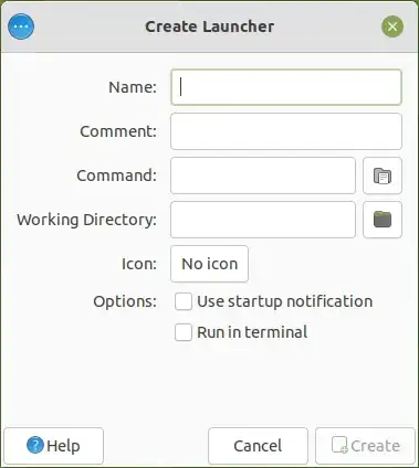

Screenshot of my application
I wrote an application (launcher creator like Linux Mint's) in Qt 5.15.2 version. I completed developing and everything was ok.

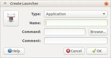

Also please do not get me wrong but we already have two mature applications for the mentioned purpose - see:
  • mate-desktop-item-edit from mate-panel package:
  • exo-desktop-item-edit from exo-utils package:
They are good replacement for previously available gnome-desktop-item-edit application from gnome-panel package (see this Q&A for details about its history).
