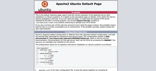

  4. Test Apache works by opening a browser and visiting http://127.0.0.1. You should see something that looks like this: Apache Test Page

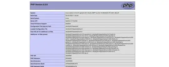

  9. Test PHP works by visiting http://127.0.0.1/testing.php in your browser. You should see something like this: PHP Info Your version number will likely be a bit different, as this was done on a 21.10 installation.
