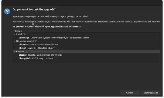

Ubuntu 21.10 Impish Indri 64-bit. As in the title: why does software update wants to remove discord (I need it and installed it for a reason, duh) and libpng12-0 (which, I know, is outdated, but I do need THIS EXACT version).
And what's these: libc++1-12 and libc++1 I don't even know (perhaps some dependencies for libpng12-0).
So I am confused over here. What do I do in order to keep my stuff and run the update?
screenshot

Alright, thanks to people in comments, I guess I got the answer:
@user535733:
Looks like your Discord deb was tied to a specific version of a dependency. If so, that's a bad idea...and you just found out why. The easy way to keep Discord in this sort of situation is to use the Snap instead of the deb.
@N0rbert
For correct way on libpng12 installation see askubuntu.com/a/1194489/66509
