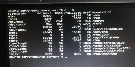

Using the version of ubuntu server 20.04 I would like to copy some files in the RAM memory from a usb stick and then transcribe them again in a second usb memory.
I currently have 32GB of RAM installed, but it looks like I can only use 16GB. enter image description here
I understand that the system to work needs a slice of memory to work, but would it be possible to repartition the ram memory in order to allocate 5GB of RAM and another 27GB of "HDD"?
I have already read that it is possible to extend this space using a USB memory, but they are not solutions for me.
UPDATE 1: the result of free-h is the following: enter image description here

You can try to resize the memory partition size using:
sudo mount -o remount,size=10G none /
  • none - doesn't matter for tmpfs
  • / - mountpoint
Example:
# mkdir /mnt/test
# mount -t tmpfs -o size=1G none /mnt/test
# df -h |grep test
none                 1,0G     0  1,0G   0% /mnt/test
# mount -o remount,size=10G none /mnt/test
# df -h |grep test
none                  10G     0   10G   0% /mnt/test
# mount -o remount,size=1000G none /mnt/test
# df -h |grep test
none                1000G     0 1000G   0% /mnt/test
Second, If you can resize it fine, you could even set it way more that your available memory, BUT keep in mind, that those files are stored in memory, and your PC will slow down event into standstill if you run out of free memory.
If you really need more than available memory you can:
  • setup a swap file/partition on some hard drive (including usb) - but keep in mind that it will not be encrypted by default
  • just create/mount some drive like normal and use it (same, you can always encrypt it)
