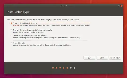

I want to install Ubuntu on my device which already has Windows 7. On my Windows 7 I have three partitions including two for storage called D and E (with no important data on them maybe a gigabyte or two) and one for Windows system called C.
Now I want to install Ubuntu instead of Windows, and on Ubuntu I want to make three brand new partitions: two for storage and one for the system, like the way it was in Windows:
C D and E drives in Windows
How can I do this? Do I choose the Something else option during the installation, or should this be done after the installation has been completed? What are the steps to follow?
Image for the installation options given
Thanks in Advance.

Yes, "Something else" will allow you to modify and assign partitions to your Ubuntu installation.
You can also boot into Ubuntu live session,
select "Try Ubuntu",
and then install GParted tool:
sudo apt install gparted
Now you can use GParted to modify your partitions to your liking
before running Ubuntu installer ("Install Ubuntu YY.MM" icon on the desktop).
Selecting "Something else" in the installer now will also allow you to add static mount points (paths) to your additional partitions.
