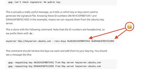

Q. Where did you get the numbers to supply in the command in step 4? (after recv-keys)
⇢ The numbers are on this page. The code block scrolls to the right:
Scroll to the Right
