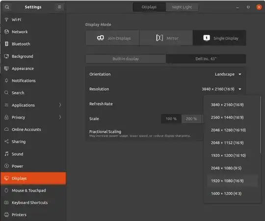

  1. In Ubuntu 20.04, go to Settings → Displays.
  2. In the Resolution dropdown, count the position of the resolution options that you care about. (In the screenshot below, "3840 x 2160" is 1st, and "1920 x 1080" is 7th.)
  3. In Terminal, xrandr -s 0 -r 30.00 will set the system to use the 1st resolution at 30 Hz (or 29.98 Hz actually, somehow), and xrandr -s 6 -r 30.00 will switch to the 7th. Test those commands.
