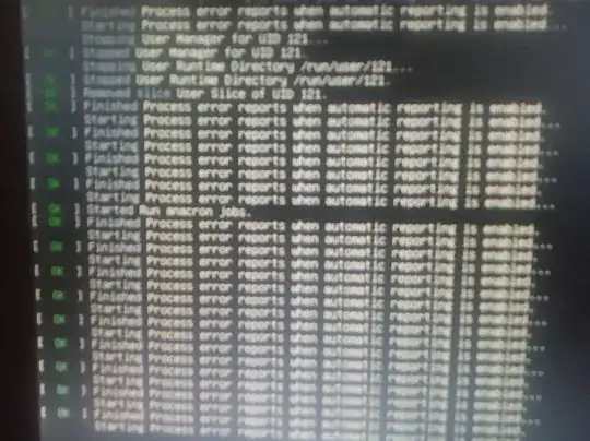

I tried to boot my old kernel but the boot is stuck on Automatic Report like below :

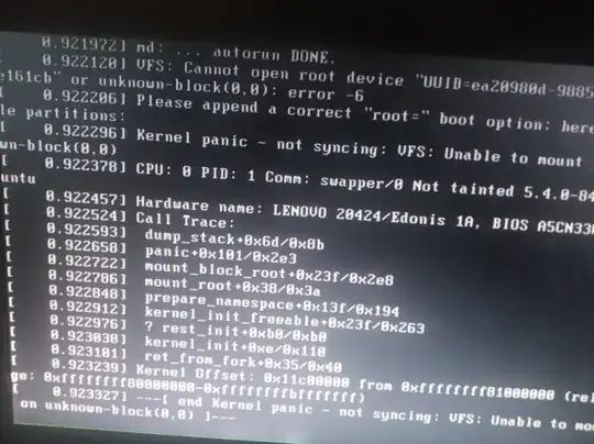

    my both kernel and the recovery mode are stuck on Kernel Panic! VFS: Unable to mount root fs on unknown-block(0,0).

i see on error output above at line:
VFS: Cannot open root device "/dev/sda7" or unknown-block(0.0)
after i checked on grub.cfg, their have different paramaters on --set-root and root=uuid=.
My partition :
  • /dev/sda1 #/boot
  • /dev/sda5 #/swap
  • /dev/sda6 #/tmp
  • /dev/sda7 #/
Well, What is the correct "root=" boot option to be?
