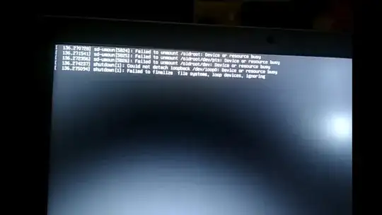

After restarting the screen flickers once displaying:
[136.270728] sd-umoun[5824]: Failed to unmount /oldroot: Device or resource busy
[136.271541] sd-umoun[5825]: Failed to unmount /oldroot/dev/pts: Device or resource busy
[136.272356] sd-umoun[5826]: Failed to unmount /oldroot/dev: Device or resource busy
[136.274237] shutdown[1]: Could not detach loopback /dev/loop0: Device or resource busy
[136.275094] shutdown[1]: Failed to finalize file systems, loop devices, ignoring
Failed to unmount

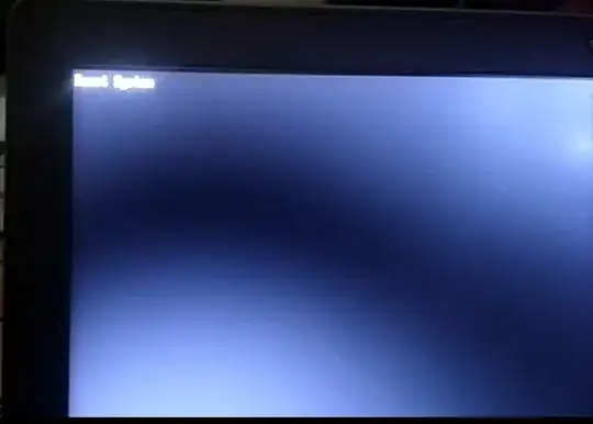

Then it displays Reset System in the corner and starts to loop.

Had the same issue, changed boot mode from "UEFI Hybrid" mode in the BIOS to the "UEFI Native" mode. The restarts stopped happening and the system booted normally.
This was on a HP Elitebook 820 G1.
