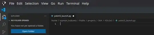

Today, I turned on my computer (Kubuntu 21.04) and found out that the Public folder is missing. I checked the trash and nothing like this was there. When I turn on VS Code it tries to open the latest script which was in the subfolder of Public. It cannot open it but VS Code shows path:
this is what it shows

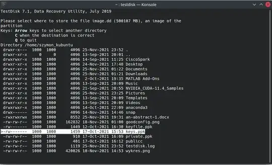

EDIT I tried to use testdisk software, however I find nothing that should be highlighted red, no trace of Public folder. testdisk output
