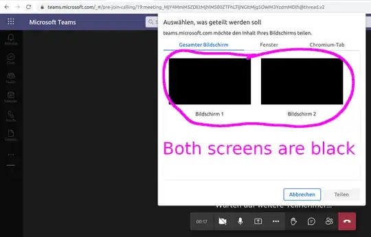

If I want to share the screen in Chromium, I see only black screens.
I can share the screen, but the other participants only see a black screen.
Sharing a window or chromium tab works fine.

Ubuntu 21.10 uses Wayland by default. Wayland is still being actively developed, and certain features like screen sharing do not function properly.
In your login screen, you can switch to the "Ubuntu"/"Ubuntu on X.Org" session, and screen sharing should work there.
