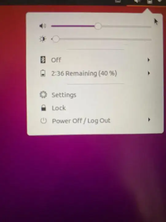

But then I ran into a problem. As you can see below, I have no option of WiFi available, so I tried looking into settings, to find the option of Wireless connections.
Photo 1

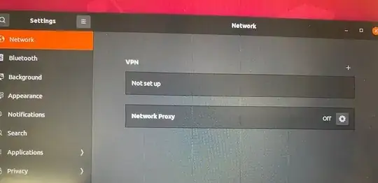

But again, I run into this, where there is no option to wireless connections:
Photo 2

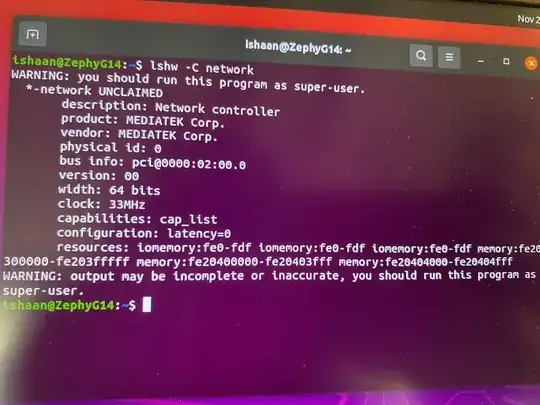

P.S. I also tried using the lshw -C network command, and I got this as an output:
Photo 3

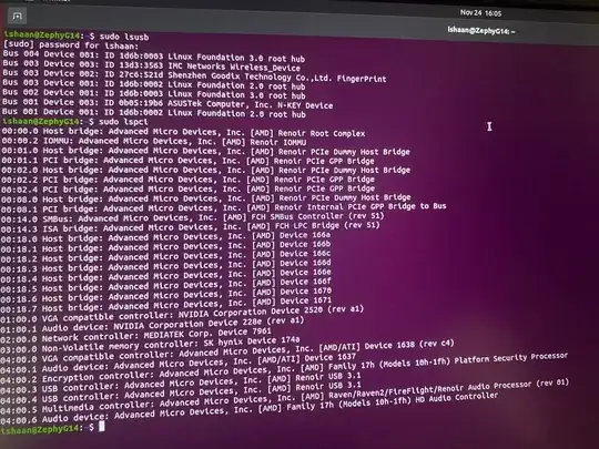

EDIT: Outputs for commands sudo lsusb and sudo lspci here
Photo 5
WiFi isn't working because Ubuntu 20.04 doesn't have a driver for your Mediatek MT7921 wireless card.
Your options are:
  • install a compatible driver
  • upgrade to a newer kernel
  • use Ubuntu 21.04 or newer
More detailed discussion and possible solutions here:
Ubuntu 20.04 does not have MediaTek driver MT7921 for WIFI & Bluetooth?
