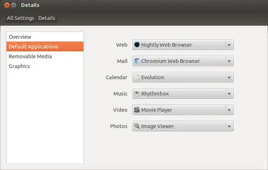

  1. System settings > Details > Default applications should open something like this: enter image description here Here you can change the preferred applications for important summary mime types.
