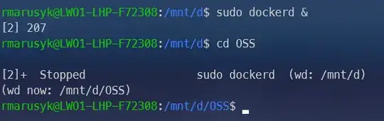

It runs but it blocks my terminal tab. To work with containers I need to open the second tab. I've tried to use sudo dockerd & - it seems to run dockerd in the background, but when I change a directory, it stops.
How can I run dockerd in the background and change directories without stopping?

    Note: Be sure to change rmarusyk to the user account you would like Docker to run under if it is not the same name as in your screenshot.
