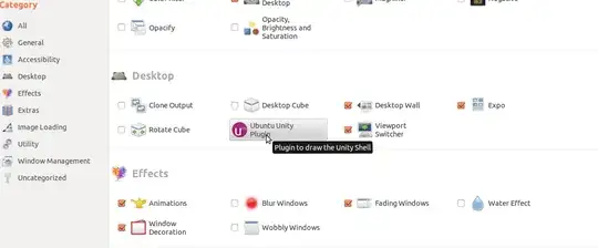

Okay. It seems like your brother disabled or played around with the unity plug-in.
If you have CompizConfigurationManager installed,open it.
Or else install it from the Software Center.
After you have it,

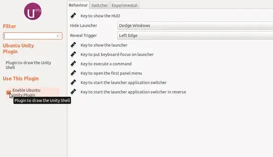

  1. Open it and go to "Ubuntu Unity Plugin" under the "desktop" menu
2.In the Settings click on the Enable Unity Plugin option.!
Step-1
Step-2
