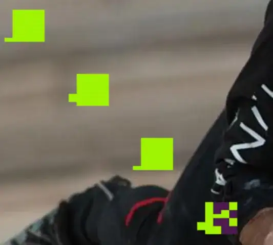

I was playing with xfce and kde with ubuntu 20.04. When I came back to gnome (ubuntu-desktop, same if I use gnome classic), the actual desktop has no icons (I cannot click on it) and there are 'green pixels' randomly in the background (i.e. if I log in/out the green pixels change position in the screen.
