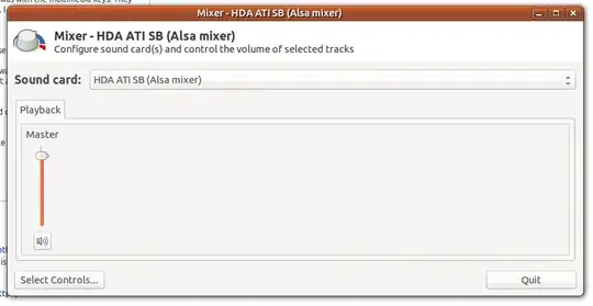

In detail, in xfce4-mixer you want it to look something like this:
xfce4-mixer

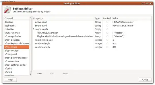

This should show only the primary volume control of your sound card. You have to choose a sound card at the top and then click "Select Controls..." to add controls. Then in the xfce4-settings-editor you need to set the "active-card" like this:
Under "sound-cards" you'll see a list of every sound card for which you added mixers. You will probably have multiple cards so it might take some trial and error here to find the right one. You need to copy the name of the correct card from "sound-cards" to "active-card" - this will be the mixer which the volume buttons control.
