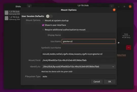

Set x-gvfs-icon with gnome-disks
If you want to be on the safe side, make a backup copy of your /etc/fstab first:
sudo cp /etc/fstab /etc/fstab.backup
Open gnome-disks (it is under Activities -> Utilities - Disks). Find the partition for which you want to change the icon, select it (it must be highlighted) and click on the gear icon ("Additional partition options").
In the menu, that pops up select "Edit Mount Options...".
In the dialog you must first switch off "User Session Defaults". Then under "Icon Name" you can place a name known to the icon theme. For a first test you could put gnome-cd, which will get you an CD-icon. How to find icon names and how to add custom ones I will explain in the following two sections.
Before clicking "OK", ensure yourself, that the other options are correct, for example "Mount at system startup". When you click "OK", enter your password, which will then save those settings in /etc/fstab. Usually gnome-disks provides you with good default options, but still you have to handle them with care.
The new entry in /etc/fstab that has been created for us could for example look like this:
/dev/disk/by-uuid/<the-uuid> /mnt/<the-uuid> auto nosuid,nodev,nofail,x-gvfs-show,x-gvfs-icon=<name-of-the-icon>,noauto 0 0

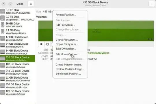

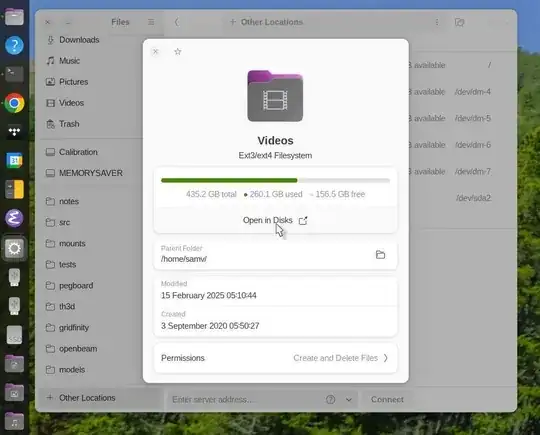

  1. open gnome-disks. You can click your way there from the file manager (nautilus), by clicking on "Other Locations" from the sidebar, right clicking a volume and choosing "Properties", then "Open in Disks"
nautilus file manager with a volume's "properties" modal window shown
  1. find the volume you want to adjust, and select "edit mount options".
gnome-disks with context menu of a volume shown

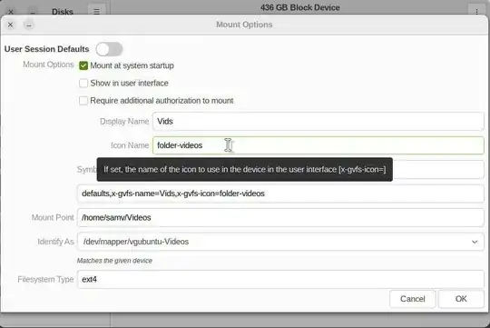

  1. enter the icon you want to use in "Icon Name", then click "OK". A list of all installed icon names by theme (set using gnome-tweaks) can be found by poking around in /usr/share/icons/THEME/; you can browse around there or cut and paste this block into a terminal to get a list of icons by theme:
cd /usr/share/icons
find . -type f |
    perl -lnaF/ -E '($icon_name=$F[4])=~s/\.\w+$//;
        next unless $icon_name =~ /folder-/;
        say "$F[1]: \"$icon_name\""
    ' | sort -u
Currently the icons found in most themes are: folder-documents folder-download folder-dropbox folder-music folder-new folder-open folder-pictures folder-publicshare folder-remote folder-templates folder-videos
gnome-disks mount options dialog, with the icon name field set to 'folder-videos' and the volume name field set to 'Vids'

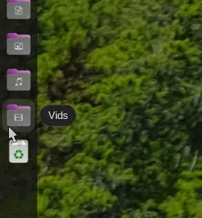

  1. You should now see the icon change in the dock. If you changed the display name on the mount options, it will update the next time you log in (or restart gnome-shell):
dock with mouse hovered over the modified volume, showing the updated icon and the modified volume name in the tool tip
