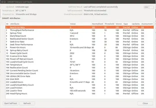

Edit: adding Disks Screenshot as recomended.

  • As per the 'Disks' program -
Disk is OK, 16 bad sectors (43° C / 109° F)
I thank you in anticipation of an urgent answer, so I can proceed with my work. Regards.
P.S: I am using Ubuntu 16.04 LTS. Only Ubuntu. I have one in-built hard-drive.
