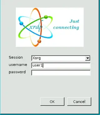

What I see when connecting from Ubuntu 20.04.3, remmina:
  1. Screen 1 with the message login failed for display 0.
    From logs below, I understand this is just a warning, but then an attempt to connect with display 10 (or display 11 if there is already an X connection using display 10) is successful.
    So I would only later bother about how to remove this initial attempt with display 0, or how to make it succeed.
  2. Screen 2 with the login prompt.
  3. A brief black screen, and then the connection window closes.
How can I fix this?

[20211103-08:20:53] [INFO ] calling auth_start_session from pid 2432
[20211103-08:20:53] [DEBUG] Closed socket 7 (AF_INET6 ::1 port 3350)
[20211103-08:20:53] [DEBUG] Closed socket 8 (AF_INET6 ::1 port 3350)
[20211103-08:20:53] [INFO ] /usr/lib/xorg/Xorg :11 -auth .Xauthority -config xrdp/xorg.conf -noreset -nolisten tcp -logfile .xorgxrdp.%s.log
[20211103-08:20:53] [CORE ] waiting for window manager (pid 2433) to exit
[20211103-08:20:55] [CORE ] window manager (pid 2433) did exit, cleaning up session
[20211103-08:20:55] [INFO ] calling auth_stop_session and auth_end from pid 2432
[20211103-08:20:55] [DEBUG] cleanup_sockets:
[20211103-08:20:55] [DEBUG] cleanup_sockets: deleting /run/xrdp/sockdir/xrdp_chansrv_audio_out_socket_11
[20211103-08:20:55] [DEBUG] cleanup_sockets: deleting /run/xrdp/sockdir/xrdp_chansrv_audio_in_socket_11
[20211103-08:20:55] [DEBUG] cleanup_sockets: deleting /run/xrdp/sockdir/xrdpapi_11
[20211103-08:20:55] [INFO ] ++ terminated session:  username user1, display :11.0, session_pid 2432, ip ::ffff:192.168.0.139:42446 - socket: 12
