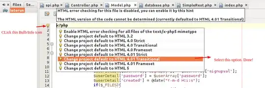

Please click on the Info (Bulb icon) on the top of the file or from where you start PHP code. After click on the bulb select “Change project default to HTML 4.01 Transitional” option and now you are able to use Enter key normally.
Please check the screenshot attached below.
