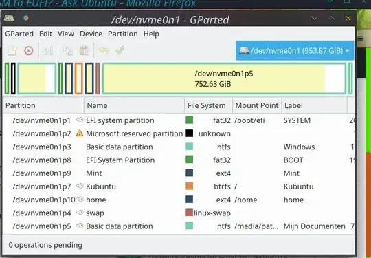

If you want to put grub on your internal SSD ( where your Windows is installed ) you need to set it to your internal drive. Although I don't see the point in this ( without the external disk it cannot boot into Ubuntu. ( see gparted ). In my case nvme0n1. see pictureenter image description here

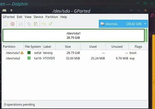

If you want to put grub on your external SSD use that drivename. In my case sda ( external usb-stick ). see pictureenter image description here
If you put grub2 on your external disk and want to boot from it you have to change your settings in your ( what many people still call ) BIOS to boot from usb first.
