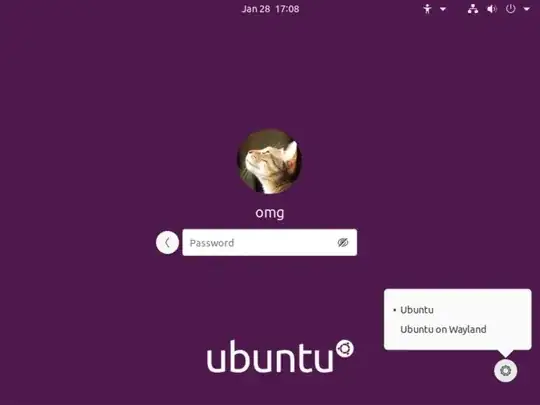

Ubuntu 21.10 uses Wayland by default. However, Wayland is still not fully ready, and many things like screen sharing, pen-tablets do not work out of the box. The workaround is to use the X.Org session in the login screen.
In your login screen, you can switch to the "Ubuntu" session, which uses X.Org, and it should allow screen recording software to function properly.
enter image description here Image source: OMG! Ubuntu!
