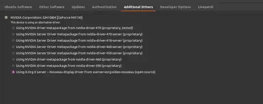

Screenshot of Additional Drivers tab

  • reinstalled Ubuntu 20.04
  • reinstalled Nvidia 470 driver from Software & Updates Additional Drivers tab
  • rebooted, and it's working fine now
