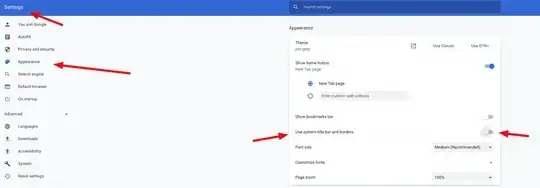

I had the same issue and the solution to it was to "Use system title bar and borders" under the settings on the "System Menu" on the upper-right hand corner in Chrome.
Navigate to settings -> appearance and the setting is in there.
As shown in this picture:enter image description here

I have a workaround for this: enable "Use system title bar and borders" in settings of Google Chrome. (You can search the setting by the name.)
