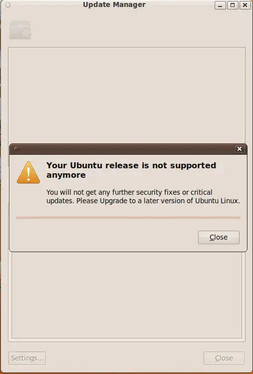

Years ago I had tried wiping the OS by installing Fedora from an ISO that I put on a CD, but I didn't know what I was doing and somehow managed to get the computer into a state where it was saying that there was no OS when I went to boot up the machine. Recently I came back to my computer in this state. I tried to continue with the Fedora installation but apparently I still don't know what I'm doing and couldn't complete the installation correctly. But when I tried rebooting to the hard drive, the computer booted up my old Ubuntu OS which I thought was gone. I was able to sign in and take the files I wanted off the machine before I messed with things any more because at this point I don't care if I'm starting from a blank slate. I tried using the Update Manager to fix things but the first thing I see when I opened it is this:

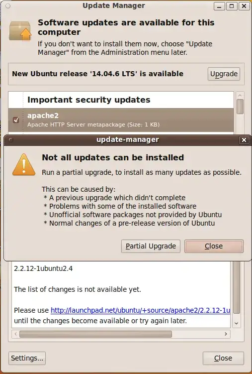

"Your Ubuntu release is not supported anymore" - "You will not get any further security fixes or critical updates. Please Upgrade to a later version of Ubuntu Linux." with the option "Close". When I click "close" it then shows this:
Not all updates can be installed

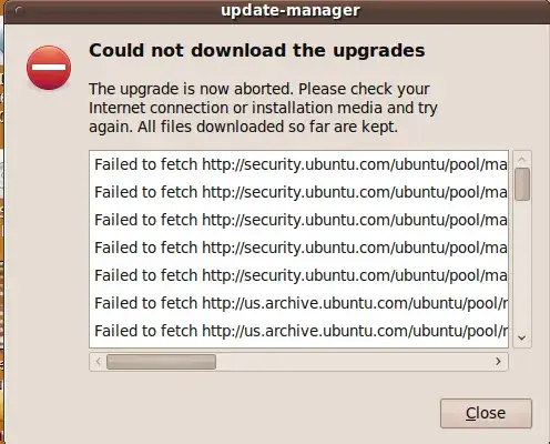

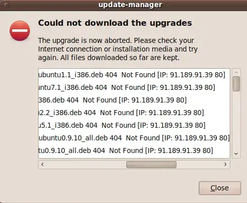

so I did "Partial Upgrade" however when I did this it was complaining about not having authentication. I figured this is probably because the OS isn't supported anymore. I found a way to add a file to bypass this authentication (I'm desperate to get things fixed). That got me past that obstacle but then I get this:
could not download the upgrades
and when you scroll to the right it says:
404 not found

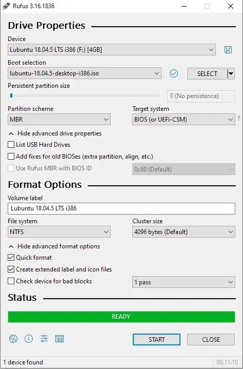

I had enough of all of this and decided to install lubuntu-18.04.5-desktop-i386 from a USB memory stick. I used rufus-3.16.exe on my Windows machine to setup the ISO on the USB stick. Here's my Rufus settings:
Rufus settings

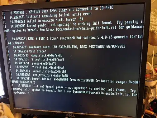

Now, maybe this next detail is the issue, but I don't suspect that it is. Apparently I have no USB sticks that are large enough to contain the ISO file. So I found a micro SD card that's large enough. I had to put the micro SD card into a micro SD to SD card adapter, and then put that into a SD card to USB adapter. Then I was able to get Rufus to setup the USB stick correctly. I got the Ubuntu machine to see the USB stick and it shows the lubuntu install screen. When I try to install it, I get kernel panic messages such as these:
kernel panic
I tried updating Initramfs on my machine before attempting this again and it seemed like it attempted to update. I'm not sure that it did.
