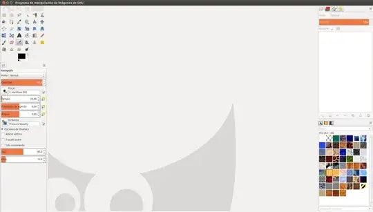

  3. Open GIMP, and go to Windows > Single-Window Mode
Now you have a single window! For example, my GIMP main menu:
