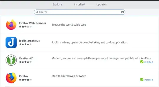

At the moment, both versions of Firefox are available through Ubuntu Software. If you want, you can remove the snap version and install the .deb version, as a temporary workaround (or continue using Firefox's snap version which will eventually get fixed).
