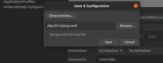

you have to do it using startup scripts, other methods doesn't work, and don't try to save it to xorg.conf , if you enable from nvidia-settings it will disable the intel display on next reboot.
DO NOT DO THIS enter image description here

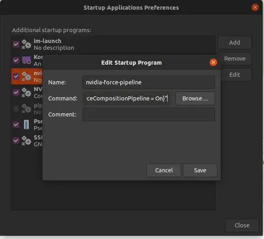

Step 2: the add it to your startup scripts enter image description here
