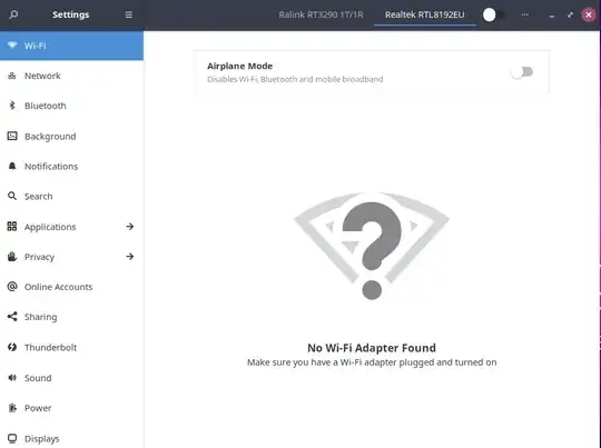

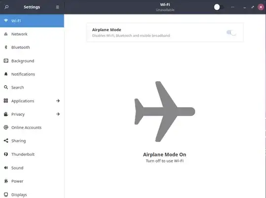

This is the condition when the Usb adapter is not plugged, I am unable to off Airplane mode at this stage.
This is the condition when I plugged the usb wifi adapter.

Finally the problem is solved. My Usb wifi Adapter was hard blocked by internal wifi card. I was able to fix this with the help of this article. Wifi Dongle hard blocked by wifi card
For removing module of the internal wifi adapter do the following
Get the kernel driver name by running
lspci -nnk | grep -iA2 net
Take the name in the line "Kernel driver in use:". Make sure that it is the correct device (the wifi card and not e.g. the ethernet card). In my case it was rt2800pci.
Then either remove it for testing temporarily using
sudo modprobe -r rt2800pci
or permanentely by adding it to the blacklist
sudo vi /etc/modprobe.d/blacklist.conf
