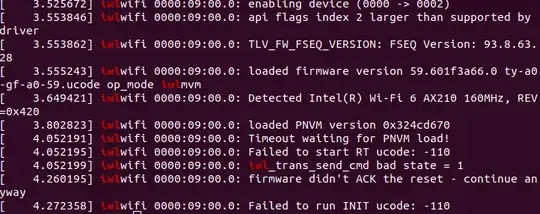

By typing the command sudo modprobe iwlwifi && sudo dmesg | grep iwl I get the following
